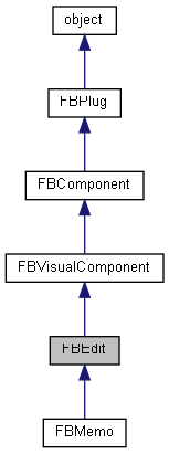

Text edit box. More...
#include <pyfbsdk_generated.h>

Text edit box.
| FBEdit | ( | ) |
Constructor.
| FBEvent OnChange |
Event: Text changed.
| bool PasswordMode |
Read Write Property: Set password mode for this edit box.
| str Text |
Read Write Property: Text displayed.
