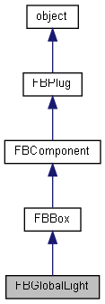

Global light class. More...
#include <pyfbsdk_generated.h>

Public Attributes inherited from FBBox | |

Public Attributes inherited from FBComponent | |

Public Attributes inherited from FBPlug | |
