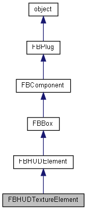

Heads Up display. More...
#include <pyfbsdk_generated.h>
Public Member Functions | |
| FBHUDTextureElement (str pName) | |
| Constructor. More... | |
Public Member Functions inherited from FBBox | |

Heads Up display.
Texture HUD element. Display a texture on a rectangle on the HUD.
