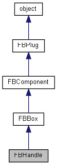

FBHandle class exposes the Handle object of the application. More...
#include <pyfbsdk_generated.h>
This is a terminal class and should not be used as a base for a new class.
Public constructor.
This constructor is used to create a new object.
| pName | Object name. |
| Select | ( | ) |
Meta selection.
With this method, the handle itself is selected as well as all the models that are manipulated by the handle.
