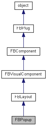

Popup window.
This class lets a window (inheriting from FBLayout) be created for another interface.
