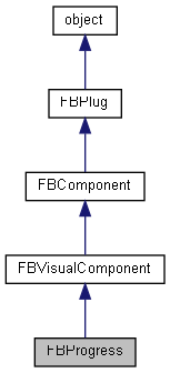

Progress bar.b>Property: Base property class. More...
#include <pyfbsdk_generated.h>
