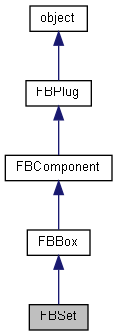

Objects Set class.
This class is an interface to manipulate object sets in the scene. Note: an item cannot be in two FBSet objects at once. Also, an FBGroup cannot contain FBSet objects, although an FBSet object can contain an FBGRoup.
