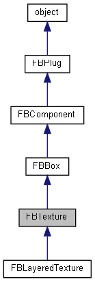

Public Member Functions | |
| FBTexture (str pName) | |
| Constructor. More... | |
| FBTexture | Clone () |
| Clone the texture. More... | |
| FBDelete () | |
| OGLInit (FBRenderOptions pRenderOptions=None) | |
Public Member Functions inherited from FBBox | |
| FBBox (str pName) | |

Public Member Functions inherited from FBComponent | |
| FBComponent () | |

Public Attributes inherited from FBPlug | |
| str | ClassGroupName |
| ClassGroupName of the object. More... | |
| int | TypeInfo |
| TypeInfo. More... | |
