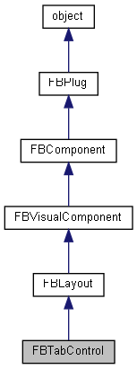

#include <pyfbsdk_additions.h>
Inheritance diagram for FBTabControl:
