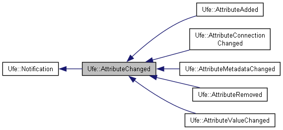

Inheritance diagram for Ufe::AttributeChanged:
Collaboration diagram for Ufe::AttributeChanged:
