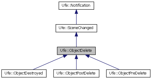

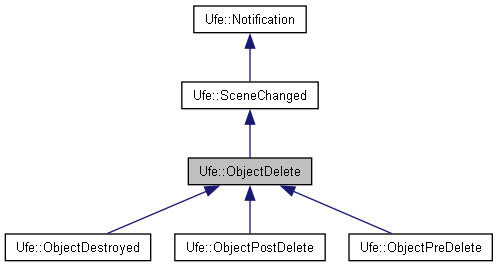

Inheritance diagram for Ufe::ObjectDelete:
Collaboration diagram for Ufe::ObjectDelete:

Base class for object delete scene notifications.
This class is the base class for object delete scene notifications. There are three ObjectDelete derived class notification types: post-delete, pre-delete and destroyed. This covers runtimes that send notification just before the object is deleted (e.g. Maya), and those that send notification just after the object is deleted (e.g. USD).
