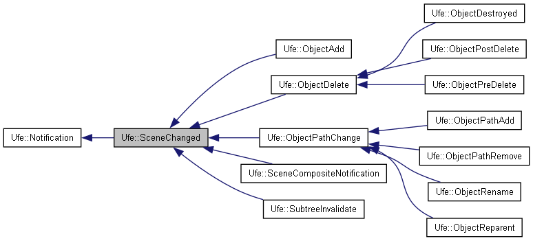

Inheritance diagram for Ufe::SceneChanged:
Collaboration diagram for Ufe::SceneChanged:

Detailed Description
Base class for all scene notifications.
This class is the base class for all scene changed notifications.
Definition at line 25 of file sceneNotification.h.
