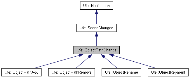

Inheritance diagram for Ufe::ObjectPathChange:

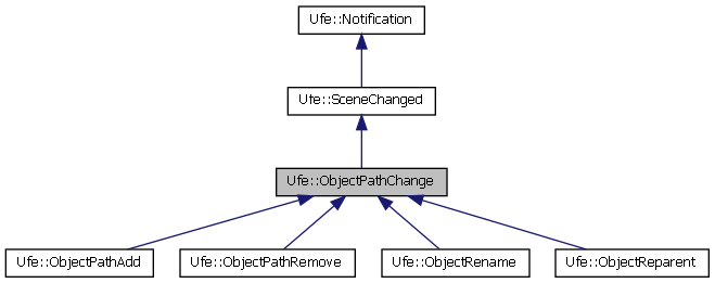

Collaboration diagram for Ufe::ObjectPathChange:
