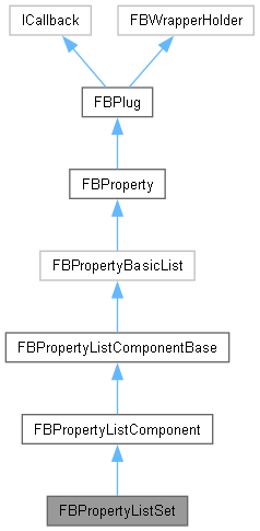

List: Set
Definition at line 80 of file fbgroup.h.
