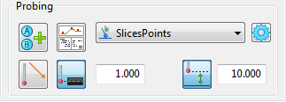

To set probing methods
Use the Probing area of the Inspect dialog to specify the probe path used to measure a feature.
Probing strategies and methods
Probing methods are grouped by strategy. The probing strategy determines how a probe path is generated and the probing method determines the shape of the path used to probe the item. Choose a probing method from the following strategies:
Note: AutoScan and UserScan are available only for probe heads that support scanning.
In addition, PowerInspect can select the AutoDefined probing method of Fallback when the item's original method is incompatible with the current probe or is unavailable in this version of PowerInspect. Because this method may produce a sub-optimal probe path, you should change it before measuring the part.
To view or change the parameters that control how the probe path is calculated, click the Parameters button.

Probe path details
Click the Details button to open Probe Path Details dialog and display the details of the probe path. The information displayed includes approach, search and retract distances and the XYZ, IJK values of each move.
