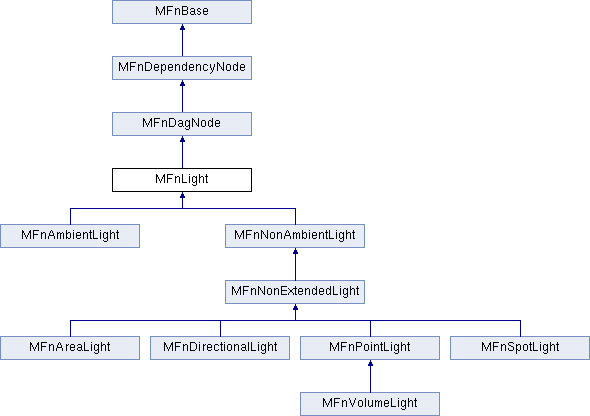

+ Inheritance diagram for MFnLight:

Manage dependency graph nodes representing lights.
MFnLight allows the creation and manipulation of dependency graph nodes representing lights. This is the top level of a hierarchy of light node function sets. It permits manipulation of the attributes common to all types of lights.
Examples:
scanDagCmd/scanDagCmd.cpp, and scanDagSyntax/scanDagSyntax.cpp.

MFn::Type type ( ) const
virtual
Function set type.
Return the class type : MFn::kLight.
Returns
the class type.
Reimplemented from MFnDagNode.
Reimplemented in MFnSpotLight, MFnNonAmbientLight, MFnNonExtendedLight, MFnAmbientLight, MFnAreaLight, MFnDirectionalLight, MFnPointLight, and MFnVolumeLight.
