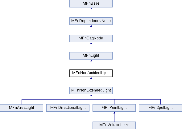

+ Inheritance diagram for MFnNonAmbientLight:

Manage Non-ambient Light dependency Nodes.
MFnNonAmbientLight facilitates modification of dependency graph nodes representing non-ambient lights. This includes area lights, linear lights, and non-extended lights.

MFn::Type type ( ) const
virtual
Function set type.
Return the class type : MFn::kNonAmbientLight.
Returns
the class type.
Reimplemented from MFnLight.
Reimplemented in MFnSpotLight, MFnNonExtendedLight, MFnAreaLight, MFnDirectionalLight, MFnPointLight, and MFnVolumeLight.
