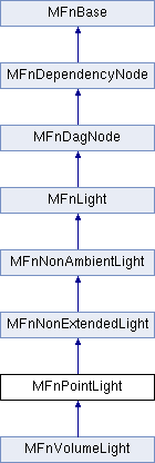

C++ API Reference
Manage Point Light dependency Nodes. More...
#include <MFnPointLight.h>
+ Inheritance diagram for MFnPointLight:
