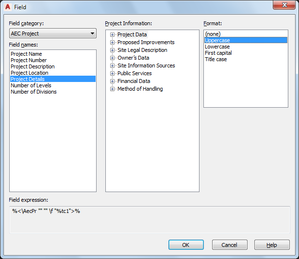

Use this procedure to select a project field to insert into a drawing.
| If you want to… | Then… |
| insert a project field into a text element | see To Insert Fields in AutoCAD Text. |
| insert a project field into a multiline text (mtext) element | see To Insert Fields in AutoCAD Multiline Text. |
| insert a project field into an AutoCAD table cell | see To Insert Fields in AutoCAD Table Cells. |
| insert a project field into an attribute definition | see To Insert Fields in AutoCAD Attributes. |
| insert a project field into a property set definition | see To Insert Fields in Property Set Definitions. |
| insert a project field into an object property | see To Insert Field Placeholders in Object Properties. |
| insert a project field into an object style | see To Add Fields to Object Style Properties. |
Under Field Names, all project-related fields are displayed.
