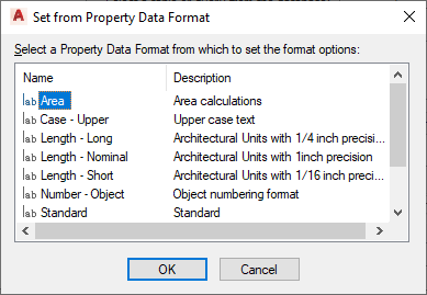

If you have selected a field or query that does not retrieve a text string, you can format the value with an existing property data format.
The settings of the selected property data format are copied to the format codes in the field.
