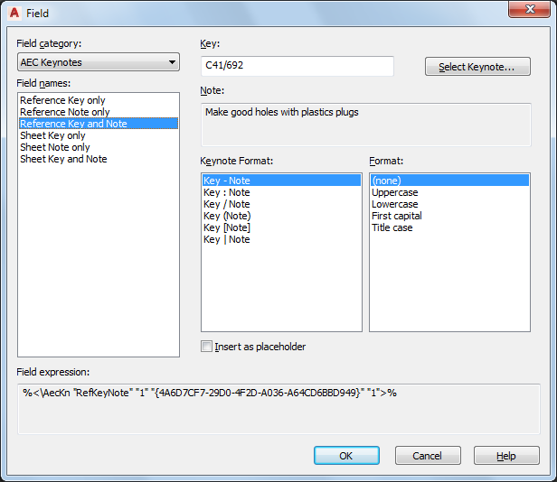

Use this procedure to select a keynote field into a drawing.

Under Field Names, all keynote-related fields are displayed.
