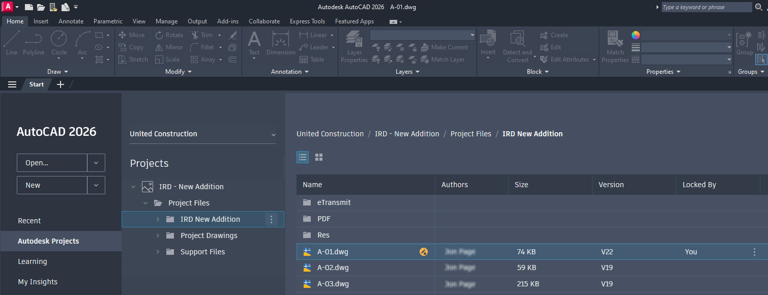

  1. Once you have an initial project selected in Desktop Connector, in AutoCAD, on the Start page, click Autodesk Projects.
  2. On the Autodesk Projects tab, expand the project for which you want to set up Connected Support Files.
  3. Browse to and open a drawing within the project.

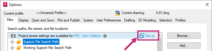

  4. With the drawing file open, right-click the drawing area and choose Options.
  5. In the Options dialog box, Files tab, click Set Up along the top of the Search Paths, File Names, and File Locations list of settings.
    Note: If you don't see the Set Up option, the project might have previously been configured. This can be verified by the appearance of the text "Current drawing is using project-aware settings."

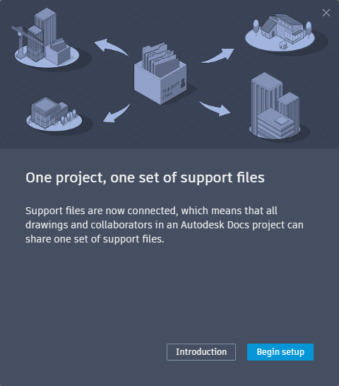

  6. In the One Project, One Set of Support Files dialog box, click Begin Setup.
    Click Introduction if you want additional information on the Connected Support Files feature.

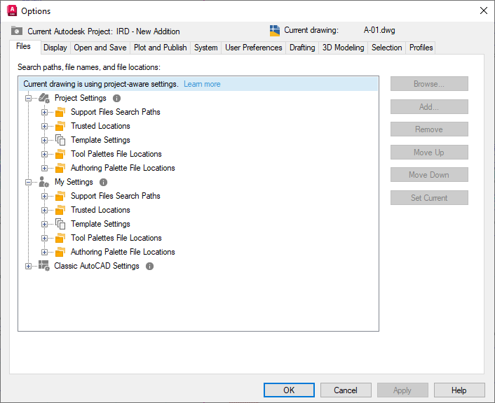

  8. On the final page, click Close Window to return to the Options dialog box.
  9. In the Options dialog box, click OK.
