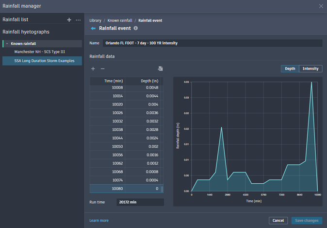

Rainfall Manager Enhancements
- Intensity-Data-Frequency (IDF) Rainfall Sets added for rainfall data management.
- Import IDF rainfall data from custom, NOAA, SSA, and Hydraflow *.csv files.
Learn more.
- Added the ability to display, hide, zoom, and expand visualization graphs for known rainfall events and IDF rainfall data.

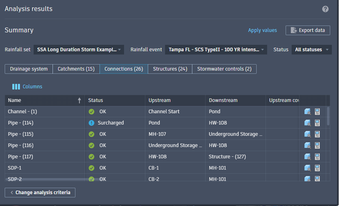

Drainage System Analysis Enhancements
- Analysis criteria is now saved as you work. Prompts to save changes have been removed to expedite workflows.
- Drainage Analysis will now prompt for a valid rainfall dataset before entering the analysis workflow.
- Added inputs and results related to the Rational methods and IDF rainfall to the analysis reporting.
- Changed the method for selecting rainfall for an analysis to use checkboxes on the Analysis Criteria page.
- Added a warning when there are no Catchment inflows when starting drainage system analysis.
- Improvements have been made when exporting analysis results by enabling export when part of the analyzed drainage system has changed. This solution allows exporting the results and analysis criteria, but the input data will remain disabled in order to avoid combining changed input values with previously returned results. The best practice is still to re-run the analysis to be sure the results match the current state of the drainage system.
