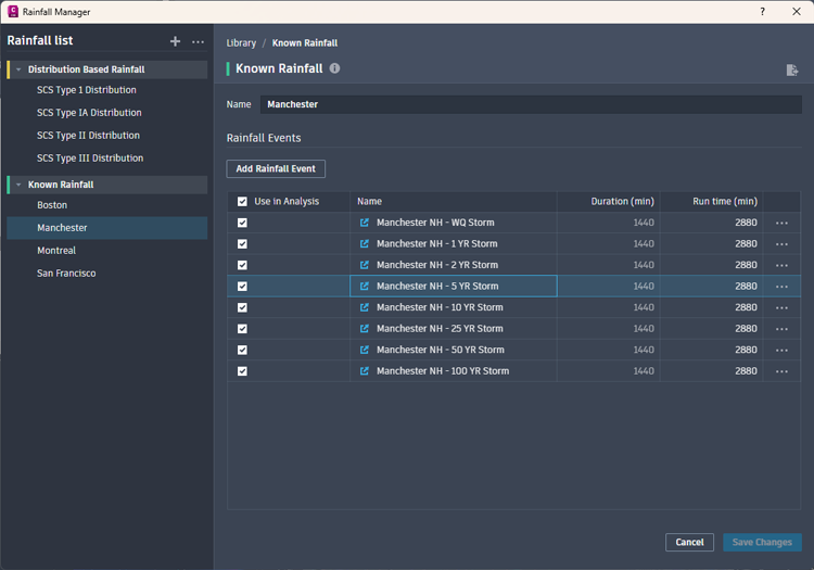

The Rainfall Manager consists of two sections. The Rainfall List panel (left) and the Rainfall Creation workspace (right).
Rainfall List
The Rainfall List is a collapsible user library of rainfall sets grouped under their respective method. Rainfall sets are groups of rainfall event data created for various purposes such as regional events, similar events, or customized testing events. Selecting a rainfall set in the Rainfall List, will display its events in the Rainfall Creation workspace.
Rainfall Creation
The Rainfall Creation Workspace has two modes. The initial empty creation mode that displays the available rainfall data methods as cards. Selecting a card, enters the rainfall set creation mode (shown above). Set creation mode allows for creating multiple rainfall data events with which to save and use for system analysis.
