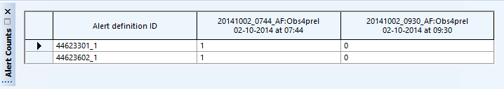

These windows contain a grid of the number of instances of each alert (displayed in the Alerts or Verification Alerts Window) for the current simulation and any comparison simulations or variant simulations loaded on the GeoPlan. These windows are displayed in the middle of the Network Page beneath the GeoPlan Window.
To display a window, click Alert Counts tab or Verification Alerts Counts tab in the middle of the Network page, or select Alert counts or Verification alerts counts from the Window menu.
Only Alert Definitions which have their Visibility field set to Grid + Theme or Grid Only in InfoWorks ICM Ultimate or ICMLive Configuration Manager will be displayed in the Alerts Window, Alert Counts Window, Verification Alerts Window, and Verification Alerts Counts Window (see the InfoWorks ICM help for more details).
To sort the items in the grid, right-click the column to be sorted and select Sort Ascending or Sort Descending from the context menu.
The columns in the Alerts window are as follows:
| Column | Description |
| Alert Definition ID |
The name of the alert, identifying the type of event occurring in the area of interest, e.g. critical pressure. Alert names are specified in the Alert Definition List set up in InfoWorks ICM Ultimate or ICMLive Configuration Manager. |
<simulation name> |
The number of times the alert occurred during the simulation identified in the column header. A column will be displayed for the base simulation and each comparison simulation or variant simulation loaded in the GeoPlan. |
