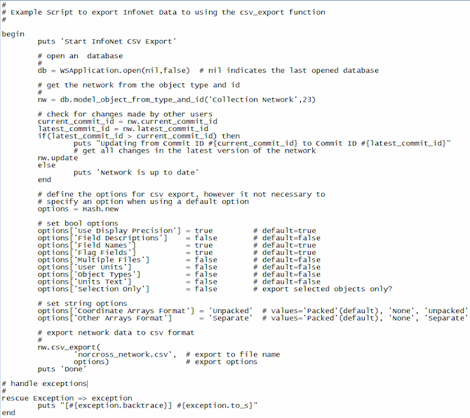

The example below provides a text version of the example script that can be copied and pasted into a text file:
Example
# Example Script to export Data to using the csv_export function
begin
puts 'Start InfoAsset Manager Export'
# open an InfoAsset Manager database
db = WSApplication.open(nil,false) # nil indicates the last opened database
# get the network from the object type and id
nw = db.model_object_from_type_and_id('Collection Network',23)
# check for changes made by other users
current_commit_id = nw.current_commit_id
latest_commit_id = nw.latest_commit_id
if(latest_commit_id > current_commit_id) then
puts "Updating from Commit ID #{current_commit_id} to Commit ID #{latest_commit_id}"
# get all changes in the latest version of the network
nw.update
else
puts 'Network is up to date'
end
# define the options for csv export, however it not necessary to
# specify an option when using a default option
options = Hash.new
# set bool options
options['Use Display Precision'] = true # default=true
options['Field Descriptions'] = false # default=false
options['Field Names'] = true # default=true
options['Flag Fields'] = true # default=true
options['Multiple Files'] = false # default=false
options['User Units'] = false # default=false
options['Object Types'] = false # default=false
options['Units Text'] = false # default=false
options['Selection Only'] = false # export selected objects only?
# set string options
options['Coordinate Arrays Format'] = 'Unpacked' # values='Packed'(default), 'None', 'Unpacked'
options['Other Arrays Format'] = 'Separate' # values='Packed'(default), 'None', 'Separate'
# export network data to csv format
nw.csv_export(
'norcross_network.csv', # export to file name
options) # export options
puts 'Done'
# handle exceptions
rescue Exception => exception
puts "[#{exception.backtrace}] #{exception.to_s}"
end

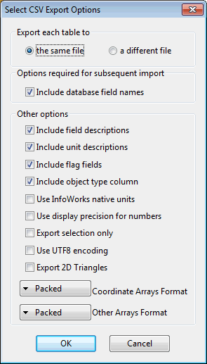

The CSV export options are defined in a hash. The options correspond to the options that are set from the Select CSV Export Options dialog n the main application.

Option Type |
Key |
Default |
Further Information |
Select CSV Export Options Dialog Option |
Boolean |
'Use Display Precision' |
TRUE |
Use display precision for numbers |
Boolean |
'Field Descriptions' |
FALSE |
Include field descriptions |
Boolean |
'Field Names' |
TRUE |
Include database field names |
Boolean |
'Flag Fields' |
TRUE |
Include flag fields |
Boolean |
'Multipile Files' |
FALSE |
Set to true to export to different files, false to export to the same file |
Export each table to |
Boolean |
'User Units' |
FALSE |
Use InfoAsset Manager native units |
Boolean |
'Object Types' |
FALSE |
Include object type column |
Boolean |
'Selection Only' |
FALSE |
To create a selection for export use: nw.select_sql(<table>,<sql query>) Where:
e.g. nw.select_sql('pipe','location IsNull')
(See the Using SQL for further information on SQL Queries in InfoAsset Manager) |
Export selection only |
Boolean |
'Units Text' |
FALSE |
Include unit descriptions |
String |
'Coordinate Arrays Format' |
PACKED |
Possible values are "Packed", "None", "Unpacked" |
Coordinate Arrays Format |
String |
'Other Arrays Format' |
PACKED |
Possible values are "Packed", "None", "Separate" |
Other Arrays Format |
