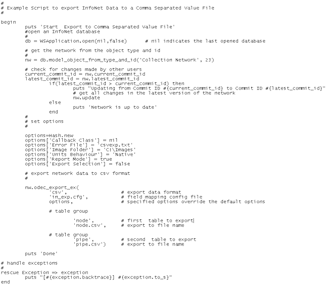

This topic contains an example script for exporting data from an InfoAsset Manager network to an external database using InfoAsset Manager Exchange. The functionality corresponds to that provided by the Open Data Export Centre within the normal InfoAsset Manager application.
The example below provides a text version of the example script that can be copied and pasted into a text file:

Click on the image below for additional information on each section of the example script:

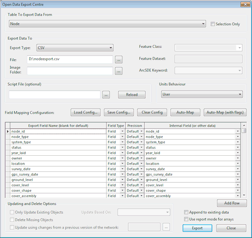

The export options are defined in a hash. The options correspond to the options that are set from the Open Data Export Centre dialog in the main application.

The export parameters correspond to the parameters that are set from the Open Data Export Centre dialog in the main application.
The first two export parameters are common to all external data source types.

Path of Configuration (CFG) file The CFG contains the mappings between the fields in the InfoAsset Manager Network and the external data source. The quickest and easiest way to create a valid configuration file for export is to use the Open Data Export Centre in the main InfoAsset Manager application. |
