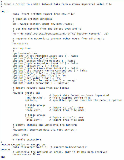

This topic contains an example script for importing CSV data to an InfoAsset Manager network from an external database using InfoAsset Manager Exchange. The functionality corresponds to that provided by the Open Data Import Centre within the normal InfoAsset Manager application.
The example below provides a text version of the example script that can be copied and pasted into a text file:
Example
        # Example Script to update InfoAsset Manager Data from a Comma Separated Value File
begin
        puts 'Start InfoAsset Manager Import from CSV File'
	       # open an InfoAsset Manager database
	       db = WSApplication.open('in.icmm',false)
	       # get the network from the object type and id
	       nw = db.model_object_from_type_and_id('Collection Network',23)
	       # reserve the network to prevent other users from editing it
	       nw.reserve
	       #set options
	       options=Hash.new
	       options['Allow Multiple Asset IDs'] = false
	       options['Blob Merge'] = false
	       options['Delete Missing Objects'] = false
	       options['Update Based On Asset ID'] = false
	       options['Update Only'] = false
	       options['Update Links From Points'] = false
	       options['Use Network Naming Conventions'] = false
	       options['Error File'] = 'csvimp.txt'
	       options['Default Value Flag'] = 'DV'
	       options['Set Value Flag'] = 'CV'
	       options['Duplication Behaviour'] = 'Merge'
	       options['Units Behaviour'] = 'Native'
	       # import network data from csv format
	       nw.odic_import_ex(
	                 'csv',                   # import data format => Comma Separated Value
	                 'in_imp.cfg',            # field mapping config file
	                 options,                 # specified options override the default options
	                 # table group
	                 'node',                  # import to table name
	                 'node.csv',              # import from file name
                 	# table group
                 	'pipe',                  # import to table name
                 	'pipe.csv')              # import from file name
        # commit changes and unreserve the network
	       nw.commit('Imported data via ruby script')
	       puts 'Done'
# handle exceptions
rescue Exception => exception
        puts "#{exception.to_s} (#{exception.backtrace})"
ensure
        # unreserve the network on error, only if it has been reserved
        nw.unreserve if nw
end
