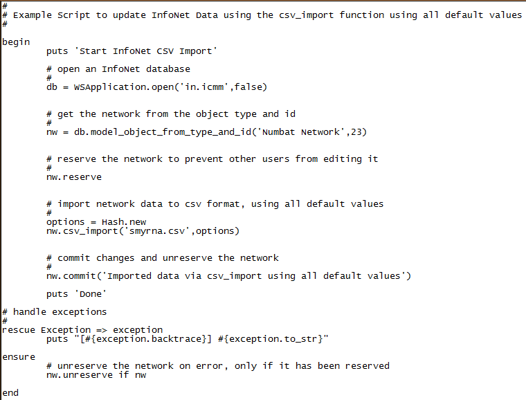

Exchange Script Examples
This section contains example scripts which provide enough information to carry out exchange of data between an external database and an InfoAsset Manager database using InfoAsset Manager Exchange.
Tip: The example scripts cover the basic functions required to carry out import and export of data. A few other useful functions are outlined at the bottom of this topic. Contact Us for details of more advanced functions.
Additional information about each section of the example script (shown below), can be found in the following sections.

db = WSApplication.open('C:\Mydatabase.icmm', false)

nw=db.model_object_from_type_and_id('Collection Network',23)

Update the local copy of the network to the latest version and reserve the network so that no-one else can edit it.
e.g.
nw.reserve

Commit changes to network and unreserve network when commit is finished.
nw.commit(<comment>)
Where:
e.g.
nw.commit('Imported data via csv import')
To commit changes and keep the network reserved, use commit_reserve
e.g.
nw.commit_reserve('Imported data via csv import')
Unreserving the Network
Used when importing to an InfoAsset Manager network.
Remove reserve from the network if an error is encountered. Changes will not be committed.
e.g.
nw.unreserve if nw
