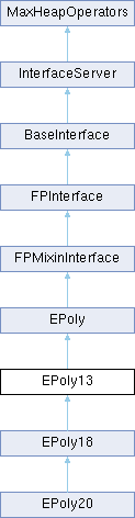

EPoly13 Class Referenceabstract
This new class extends EPoly with new functionality, in particular the ability for epoly to support manipulate grips. More...
#include <C:/adskgit/3dsmax/3dsmax/3dswin/src/maxsdk/include/iepoly.h>
Inheritance diagram for EPoly13:
