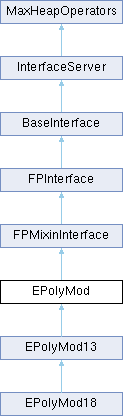

EPolyMod Class Referenceabstract
This class is the published interface for Edit Poly modifiers. More...
#include <C:/adskgit/3dsmax/3dsmax/3dswin/src/maxsdk/include/iEPolyMod.h>
Inheritance diagram for EPolyMod:

Public Member Functions inherited from FPMixinInterface
 FPMixinInterface ()
virtual LifetimeType LifetimeControl ()
virtual CoreExport bool RegisterNotifyCallback (InterfaceNotifyCallback *incb)
virtual void UnRegisterNotifyCallback (InterfaceNotifyCallback *incb)
CoreExport ~FPMixinInterface ()
virtual BaseInterface * GetInterface (Interface_ID id)
virtual FPInterfaceDesc * GetDescByID (Interface_ID id)
virtual Interface_ID GetID ()
Public Member Functions inherited from FPInterface
virtual CoreExport FPStatus Invoke (FunctionID fid, TimeValue t=0, FPParams *params=NULL)
virtual FPStatus Invoke (FunctionID fid, FPParams *params)
virtual CoreExport FPStatus Invoke (FunctionID fid, TimeValue t, FPValue &result, FPParams *params=NULL)
virtual FPStatus Invoke (FunctionID fid, FPValue &result, FPParams *params=NULL)
virtual CoreExport FunctionID FindFn (const MCHAR *name)
virtual CoreExport BOOL IsEnabled (FunctionID actionID)
virtual CoreExport BOOL IsChecked (FunctionID actionID)
virtual CoreExport BOOL IsVisible (FunctionID actionID)
virtual CoreExport FunctionID GetIsEnabled (FunctionID actionID)
virtual CoreExport FunctionID GetIsChecked (FunctionID actionID)
virtual CoreExport FunctionID GetIsVisible (FunctionID actionID)
virtual ActionTable * GetActionTable ()
virtual void EnableActions (BOOL onOff)
Public Member Functions inherited from BaseInterface
virtual UtilExport ~BaseInterface ()
 Destructor.
virtual BaseInterface * AcquireInterface ()
virtual void ReleaseInterface ()
virtual void DeleteInterface ()
virtual BaseInterface * CloneInterface (void *remapDir=nullptr)
Public Member Functions inherited from InterfaceServer
virtual UtilExport ~InterfaceServer ()
 Destructor.
template<class InterfaceType>
InterfaceType * GetTypedInterface ()
Additional Inherited Members
