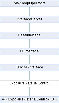

Inheritance diagram for ExposureMaterialControl:
