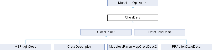

ClassDesc Class Referenceabstract
Class descriptors provide the system with information about the plug-in classes in the DLL. More...
#include <C:/adskgit/3dsmax/3dsmax/3dswin/src/maxsdk/include/plugapi.h>
Inheritance diagram for ClassDesc:

Detailed Description
The developer creates a class descriptor by deriving a class from ClassDesc2 (which derives from ClassDesc) and implementing several of its methods.
