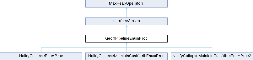

Inheritance diagram for GeomPipelineEnumProc:
