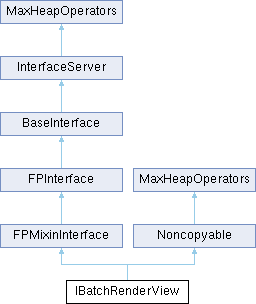

Inheritance diagram for IBatchRenderView:
