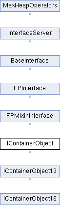

Inheritance diagram for IContainerObject:
