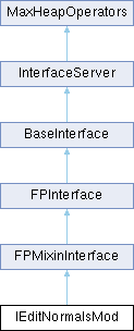

Inheritance diagram for IEditNormalsMod:
