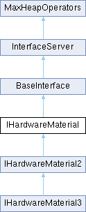

Inheritance diagram for IHardwareMaterial:
