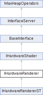

Inheritance diagram for IHardwareRenderer:

The basic idea of this class is to provide the developer with access to the DirectX device without actually giving the developer total control, and thus possibility to de-stable the 3ds Max Viewports.
A pointer to this class can be obtained with the following code snippet:
ViewExp *pview = GetCOREInterface()->GetActiveViewport();
GraphicsWindow *gw = pview->getGW();
Definition GraphicsWindow.h:73
Definition ihardwarerenderer.h:55
virtual UtilExport BaseInterface * GetInterface(Interface_ID id)
Definition maxapi.h:797
virtual GraphicsWindow * getGW()=0
CoreExport Interface * GetCOREInterface()
#define HARDWARE_RENDERER_INTERFACE_ID
Definition ihardwarerenderer.h:25
For an example usage of this class see MAXSDK/SAMPLES/HardwareShaders/LightMap/Lightmap.cpp
Member Function Documentation
◆ GetID()
virtual Interface_ID GetID ( )
inlinevirtual
Remarks
This method returns the unique interface ID.
Reimplemented from IHardwareShader.
Reimplemented in IHardwareRendererST.
