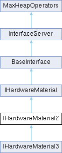

Extension of IHardwareMaterial Interface.
This class extends the functionality of IHardwareMaterial. To acquire this interface, simply call GetInterface(IHARDWARE_MATERIAL2_INTERFACE_ID). If failed, it will return NULL.
pure virtual |
This method sets the self illumination mode.
| [in] | bOn | - If FALSE, the SelfIllumColor is off.Otherwise, the SelfIllumColor is on. |
