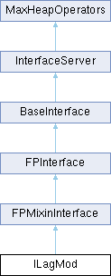

ILagMod Class Referenceabstract
#include <C:/adskgit/3dsmax/3dsmax/3dswin/src/maxsdk/include/ilag.h>
Inheritance diagram for ILagMod:
