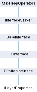

Inheritance diagram for ILayerProperties:
