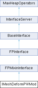

Inheritance diagram for IMeshDeformPWMod:
