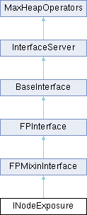

INodeExposure Class Referenceabstract
class INodeExposure: public FPMixinInterface More...
#include <C:/adskgit/3dsmax/3dsmax/3dswin/src/maxsdk/include/INodeExposure.h>
Inheritance diagram for INodeExposure:
