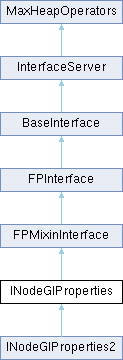

Inheritance diagram for INodeGIProperties:
