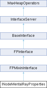

Inheritance diagram for INodeMentalRayProperties:
