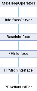

Inheritance diagram for IPFActionListPool:
