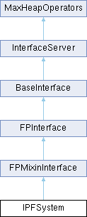

3ds Max C++ API Reference
#include <C:/adskgit/3dsmax/3dsmax/3dswin/src/maxsdk/include/ParticleFlow/IPFSystem.h>
