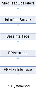

IPFSystemPool Class Referenceabstract
#include <C:/adskgit/3dsmax/3dsmax/3dswin/src/maxsdk/include/ParticleFlow/IPFSystemPool.h>
Inheritance diagram for IPFSystemPool:
