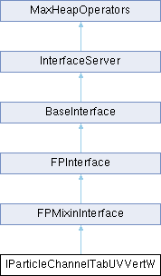

Inheritance diagram for IParticleChannelTabUVVertW:
